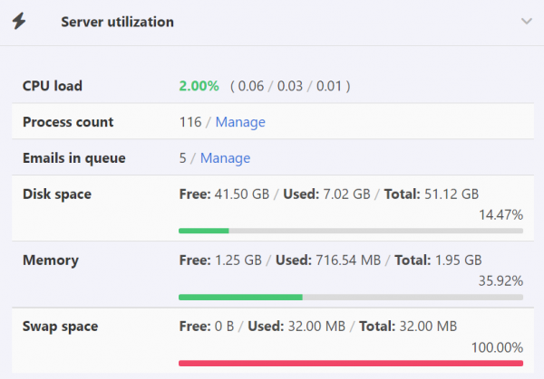

Pls see attached. I am not. Maybe I have not set swap properly?
Re: IMUNIFYAV
You must check it when it runs.
Re: IMUNIFYAV
Than ClamAV will require less RAM.
Re: IMUNIFYAV
Your 32MB ought to be 32GB
Re: IMUNIFYAV
It is set to custom and the box is empty
Is it possible to set the swap to 4 gb in keyhelp admin?
@24unix
The vps has only 2 gb ram
Re: IMUNIFYAV
no, you either need a bigger swap parttion or you create a swapfile.
Both cannot be done in Keyhelp.
Re: IMUNIFYAV
Then you should use at least 4GB Swap.
But 32MB(!) are useless.
