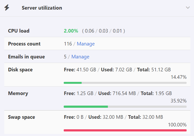

Post by prune »
Alexander wrote: Wed 15. Feb 2023, 11:40 You run out of memory?
Pls see attached. I am not. Maybe I have not set swap properly?
Posts: 1773
Re: IMUNIFYAV
You are OK because the AV scanner is not running.
You must check it when it runs.

prune wrote: Wed 15. Feb 2023, 11:49
Your 32MB ought to be 32GB :)

Post by prune »
@alexander
It is set to custom and the box is empty
Is it possible to set the swap to 4 gb in keyhelp admin?
@24unix
The vps has only 2 gb ram
Posts: 1773
Re: IMUNIFYAV
no, you either need a bigger swap parttion or you create a swapfile.
Both cannot be done in Keyhelp.
Posts: 2098
Re: IMUNIFYAV
prune wrote: Wed 15. Feb 2023, 12:13 @24unix
Then you should use at least 4GB Swap.
But 32MB(!) are useless.
